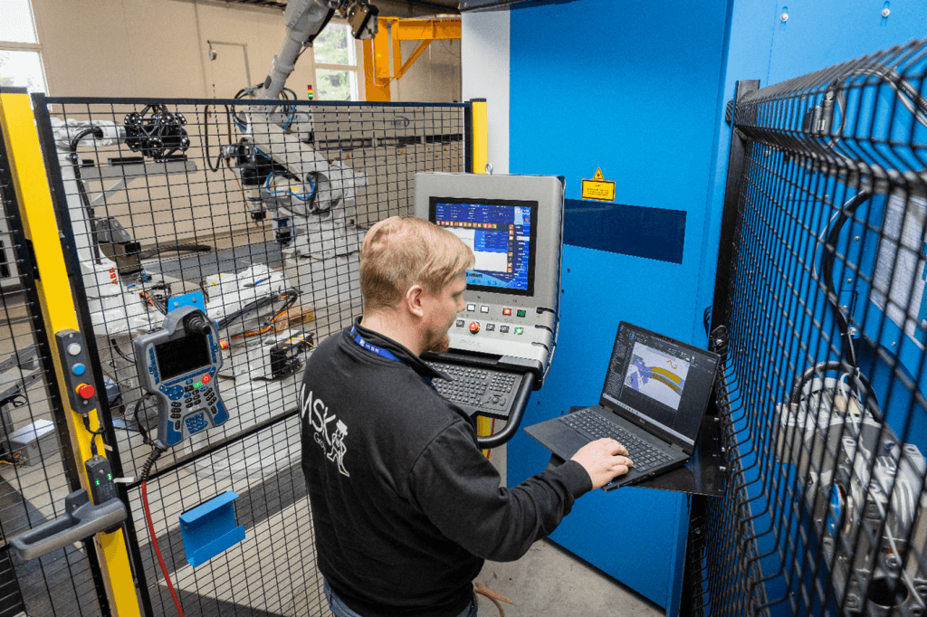

The calibration process uses the robot itself to measure the surroundings and the external axes in the robot cell. Components are then positioned in the simulation layouts according to those measurements and cross-referenced with information from the robot backup. This approach creates highly accurate layout models where locations of external axes are defined with precision. The resulting robot programs and MultiMove synchronization programs achieve the accuracy needed for production deployment.
Visual Components includes extended OLP calibration tools for self-commissioning robot cells. For teams new to OLP or those without prior commissioning experience, expert-led calibration support is available to ensure accurate setup from the start. This support helps establish proper calibration workflows that teams can then apply independently on future projects. Depending on the cell complexity, initial implementation and calibration typically takes 4 to 8 working days.

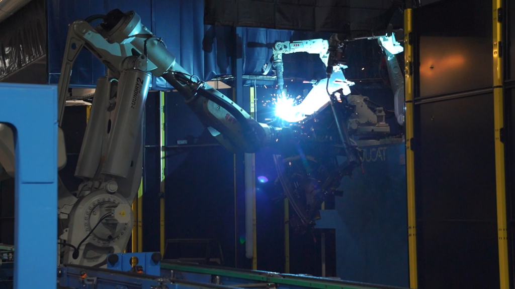

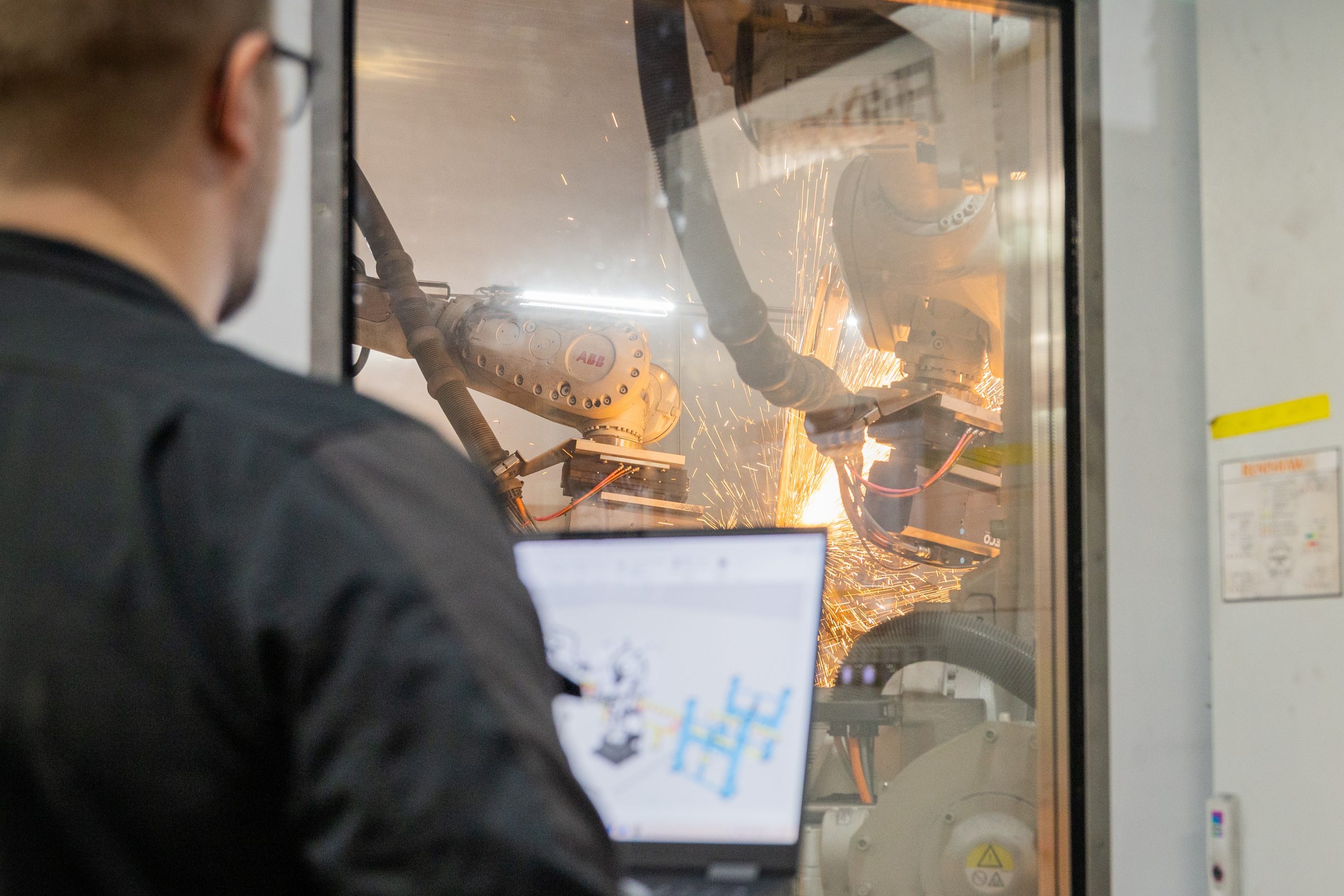

MSK Finland uses Visual Components OLP to program ABB MultiMove and ABB robot cells for welding and grinding. Their Jucat module welding cell runs 3 robots controlled by 1 controller, with a jig handling robot working as workpiece positioner for 2 welding robots. Their other Jucat frame welding cell uses 2 robots, 2 workpiece positioners and 1 floor track, all controlled by 1 controller. They also run a grinding cell with 2 ABB robots on separate controllers. All three cells were concepted and fully programmed offline before the real cells were assembled.
