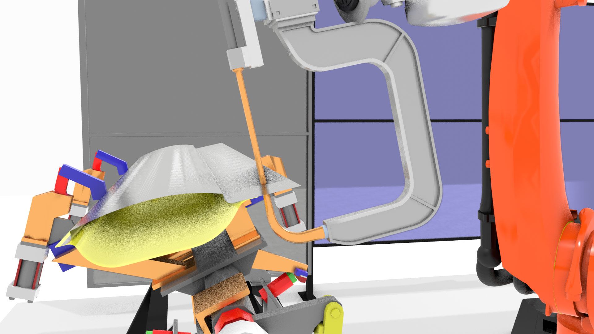

A clamp positioned on top of a weld joint. In offline programming, you find this early and choose: reposition the clamp, remove it during welding via an I/O command (so automation opens it partway through the cycle), or redesign the fixture. On the shop floor, any of those fixes costs days.
Or a short torch that can’t reach a deep cavity without the robot arm colliding with the part edge. You need a longer torch, but every tool change adds production time. In the offline programming environment you figure out the minimum number of tool changes and plan around them.

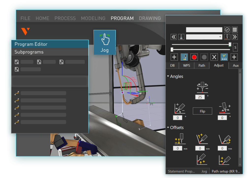

| Seam reachability and torch angles |
| Every weld seam gets tested against actual robot kinematics. The software calculates exact angles. A 90-degree torch angle is always exactly 90 degrees, not 89 or 91. The human eye can’t distinguish a one-degree deviation on a teach pendant screen, but in the offline programming environment you can zoom in and see it clearly. And it’s repeatable every time. When calibrations are done right, the digital cell model produces production-accurate programs. |
| Fixtures and clamping |
| You can test different fixtures, assemblies, and clamping positions digitally. You can check automatic fixture signal commands (open/close via I/O) and even run full PLC control logic for fixture automation. Some manufacturers and integrators do complete virtual commissioning of the entire fixture system in software before a single physical component gets installed. |

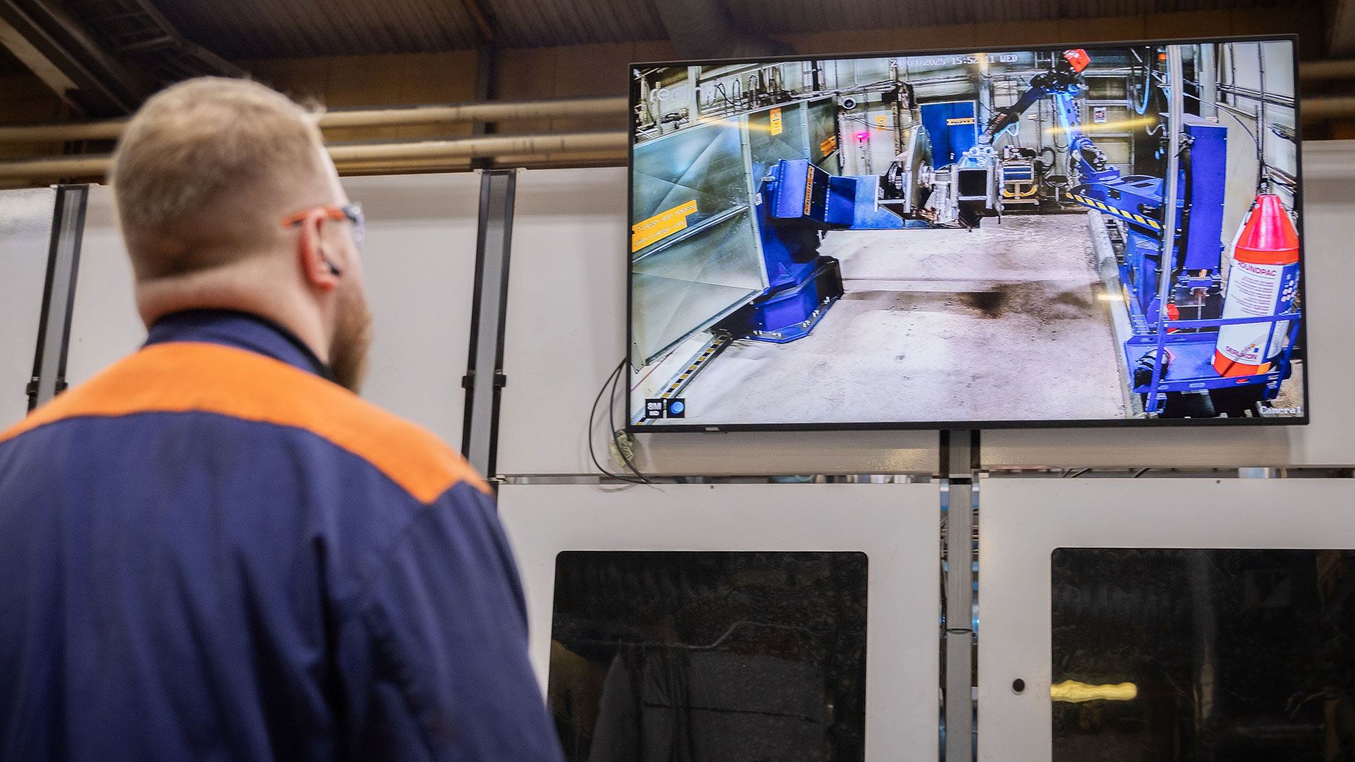

Duun Industrier is a good example. They started OLP at the quotation stage, while they were still requesting quotes from integrators for a new welding cell. They used offline programming to figure out fixture requirements and cell configuration. While waiting for the physical cell to arrive, they programmed the entire workpiece. When the robot was installed, they already had a program ready. Production started on day one.

Duun Industrier: production from day one, plus a digital WPS
Duun pre-programmed their cell before the robot arrived. They also built a custom WPS (Welding Procedure Specification) database directly in the software. All welding parameters, positions, and standards that used to live in paper documents or PDFs in a quality management system are now in one place. When you create welds in the software, the database shows the right parameters for each position. Designers, welding engineers, and operators all work from the same data.

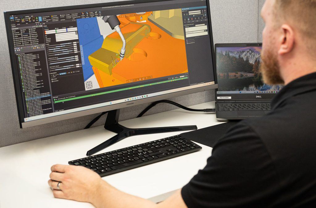

Sandvik doubled their robotic welding capacity in recent years. What’s especially relevant here is how they use Visual Components beyond robot programming to plan jigs and fixtures before production. By creating a point cloud of torch paths and determining the best frame assembly position relative to the welding positioner, they give highly accurate boundary conditions to the jig designers. This approach helped them achieve a jig that ensures full reachability and ideal welding positions for every weld.
The results show in ramp-up speed. Programming for large frames can now be prepared offline, with ramp-up completed in just a few weeks. For smaller projects, offline programming is done in a few days, with final touch-up in the robot cell taking a single shift. Weld quality has improved through standardized multi-pass welding templates, and the process is more consistent across assemblies.
